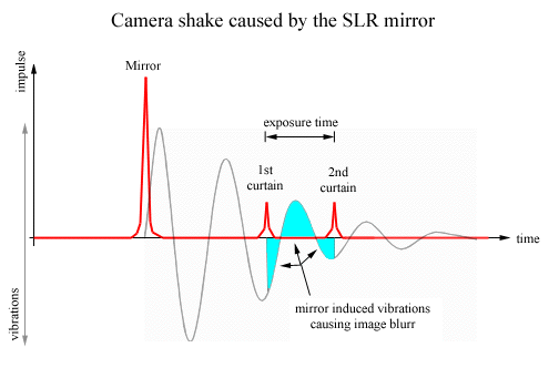

Mirror causes vibrations by moving to its upward position or to be more
precise: the vibrations are caused by the impulse produced by stopping
the mirror. The power of the impulse is dependent on the camera model.
There is little can be done about (A), whereas the effects of (B) could
be substantially reduced. The diagram below illustrates the problem of
mirror induced vibrations.
These vibrations are wave-shaped, which means finally nothing else than
periodical up- and downward movement of the camera. This movement can cause
a certain blur effect which can result in a deterioration of image quality
(see picture below). This problem is not relevant at all shutter speeds
reciprocal to lens’s focal range (for example 1/200 for 200 mm lens) but
it can and will have an effect between, lets say, 1/60s and 1/4s. So what
can be done about it? First, modern SLR cameras offer improved mirror-dumping
mechanisms. Second, many mid and upper class camera models provide a feature
called "mirror lock-up" (MLU). The idea about MLU is that the mirror is
activated long before the shutter mechanism is released. Therefore the
mirror vibrations have time to be eliminated or at least damped to an uncritical
level. There a two types MLUs:

imagine why RF and SLR are such different animals. Here is more; “look
ma – no mirror” approach leads to the whole spectra of unique abilities
characteristic to the RF system only. Generally, RF cameras produce vibrations
magnitudes smaller compared to those of SLR’s, as there is no mass transfer
related to the mirror movement. In practice it translates into exceptional
ability to shoot at shutter speeds 2-3 f/stops below limits set by the
rule of focal length reciprocity commonly used with SLR cameras without
fear to get blurry images. For example, shutter speeds ranged between 1/8-1/15
