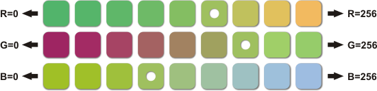

The figure below exemplifies how the proportions of red, green and blue affect the look of a color. A reference color (‘perforated' patch) was selected, its R, G and B proportions being unequal (otherwise it would have been grey).
The diagram shows the effects of keeping two color components constant while varying the other in steps of ~ 12.5%
