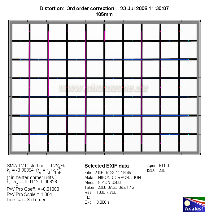

As to be expected from a fix-focal lens and especially for a macro lens the level of distortions is quite negligible.

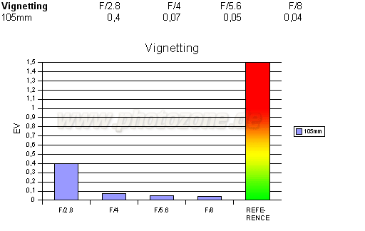

On the Nikon D200 with its reduced (APS-C) image format the (full format) lens exhibits very little vignetting at f/2.8 and from f/4 & up the issue is absolutely negligible.

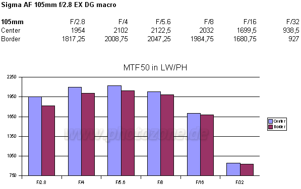

Typical for most macro lenses the Sigma AF 105mm f/2.8 EX DG macro performed great in the MTF lab. The lens is already excellent in the center at wide-open aperture with marginally worse corners. The peak performance is reached at around f/5.6 with an excellent center and border quality. As usual diffraction is the limiting factor at smaller aperture settings. Extremely small apertures such as f/32 should be avoided due to very pronounced softness. The tested sample showed a slightly uneven resolution distribution.

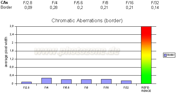

The Sigma shows an exceptionally low degree of chromatic aberrations (color shadows at harsh contrast transitions) which are negligible in field conditions.
