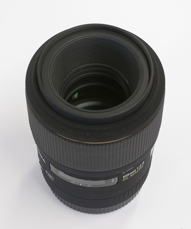

The construction feels very solid with the typical Sigma EX ("Excellence") finish (crinkle style). The very broad, rubberized focus ring operates very smooth and is well damped. Typical for most macro lenses the length of the lens grows substantially when focusing towards closer distances. Besides the lens and a dedicated bag the package also includes a screw-in, barrel-type lens hood but this is really a strictly optional accessory item because the front element resides deep within the lens (about 2cm below the front - see below).
Thanks to the screw-in approach there're advantages with polarizers which can still be used with a mounted hood. The front element of the lens does not rotate. The lens incorporates a Dual-Focus (DF) mechanism which allows to decouple the focus ring from the focusing gear by pulling/pushing it back and forth. In "manual focus" mode the camera's AF screw drive remains coupled so unless you disable AF on the camera you will end with a rotating focus ring. On the D200 the AF speed is fine for a macro lens but you should take advantage of the focus limiter when using the lens for non-macro applications in order to avoid focus hunting throughout the focus range.
