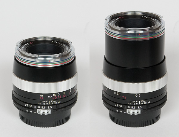

The build quality of the lens is excellent thanks to an outer metal shell and very tight
tolerances. The lens has a sturdy mono cam focus design and it extends when focusing towards
very close distances. The focus ring operates very smooth and exceptionally very well damped.
It takes a ~270 degree turn from infinity to the most extreme close focus setting (1:3.5
max. magnification). Due to the very moderate max. aperture it is a tiny lens but don't
expect it to be super light-weight. As you may have guessed the Voigtlander 90mm f/3.5 is a
full-format lens and when used on an APS-C DSLR its field-of-view is equivalent to about 135mm.
The Voigtlander behaves like a Nikon Ai-S lens with manual focusing and manually
controlled (automatic) aperture. Therefore it is not compatible to base class Nikon DSLRs.
However, it handles like a breeze on the Nikon D200 and manual focusing is fairly easy
thanks to an active focus indicator in the viewfinder.
