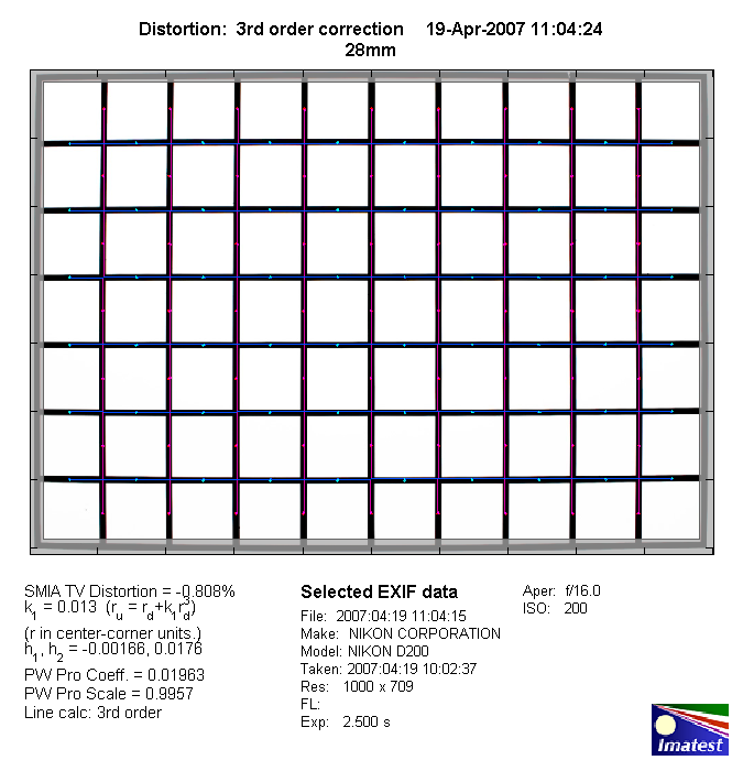

The AF 28mm f/1.4D exhibits only a slight degree of barrel distortions (0.8%).

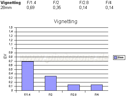

The AF 28mm f/1.4D is a full frame lens thus enjoying a sweet spot advantage on APS-C DSLRs. Despite its ultra-large aperture the vignetting is still moderate at f/1.4. From f/2 onwards the problem is basically negligible.

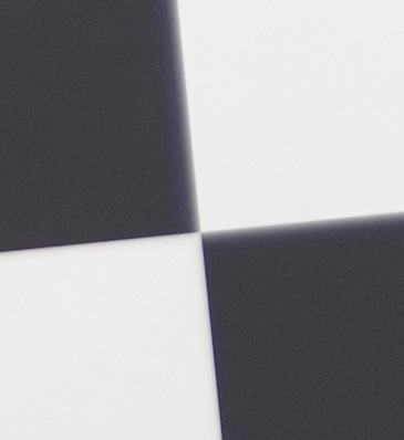

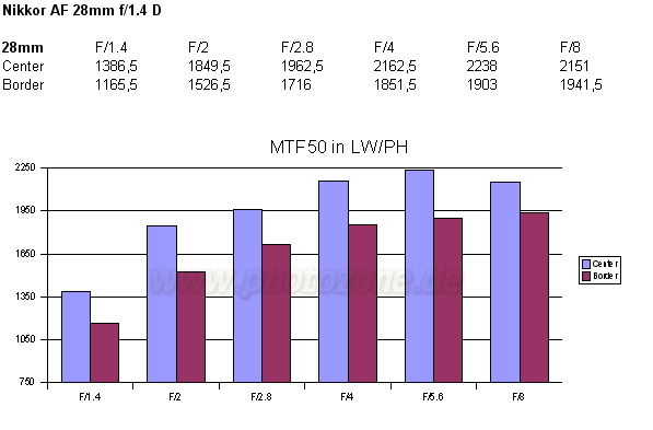

Unfortunately the Nikkor showed a rather pronounced centering defect (this is a 100% center crop) which spoiled the MTF results quite a bit specifically at large aperture settings. Typical for such defects it helps to stop down and from f/2.8 onwards the results are very impressive with an extremely high center performance and very good borders. A fully valid sample should perform even better.

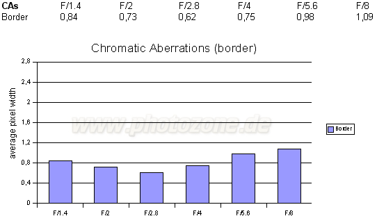

Chromatic aberrations (color shadows at harsh contrast transitions) are relatively well controlled for a wide-angle lens. At around 1px on the average the problem can be visible but it's usually no critical issue (and a correctable one anyway).
