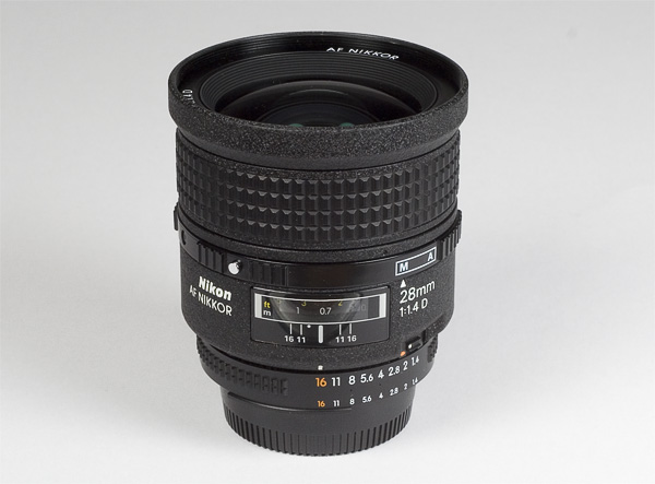

The build quality of the lens is superb - most outer parts are made of metal
and the focus ring operates very smooth and slightly damped. The length of
the lens remains constant regardless of the focus setting and the front element
does not rotate thanks to an IF (internal focusing) design.
The lens has no dedicated AF motor and relies on a slotted drive screw
operated by the camera. As a result AF operation will generate a moderate
degree of noise. Due to the moderate weight of the optical system the
AF speed is quite fast on the D200.
| Optical construction | 11 elements in 8 groups inc. 1 aspherical element |
| Number of aperture blades | 9 |
| min. focus distance | 0.35m (max. magnification ratio 1:8.3) |
| Dimensions | 75x78mm |
| Weight | 520g |
| Filter size | 72mm (non-rotating) |
| Hood | Nikon HK-7 (optional), barrel shaped, snap-on type |
| Other features | Close-Range Correction (CRC) system (also called floating elements elsewhere). Lens provides distance (D) information to the camera. |
