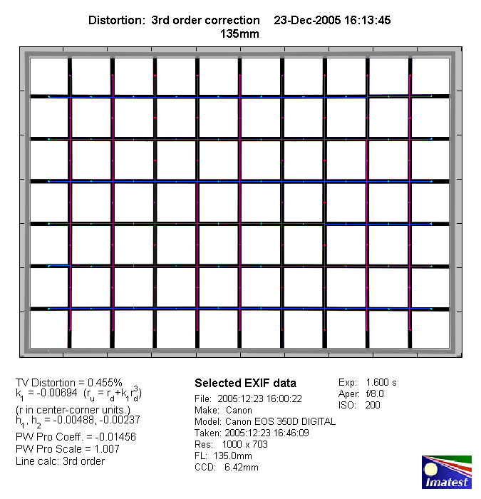

As to be expected from a tele fix-focal lens the level of distortions is very low and nothing to worry about under field conditions.
135mm:

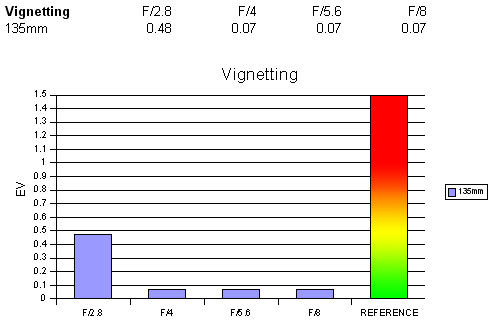

On the EOS 350D with its reduced format (APS-C) the (full format) lens exhibits slight vignetting at f/2.8 which shouldn't be problem in most scenes. One stop down the issue is negligible.

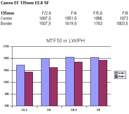

The lens may be a little dated but with disabled soft-focusing it delivers very respectable resolution figures under lab conditions. At wide-open aperture the center performance is very good with good borders. From f/4 & up the center is excellent with steadily increasing borders which reach their (also excellent) peak resolution at f/8. The lens is marginally worse than the EF 100mm f/2.8 USM macro and EF 135mm f/2 USM L.

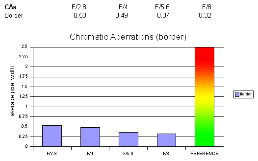

Similar to most other fix-focal lenses chromatic aberrations (color shadows at harsh contrast transitions) are very low and no real issue.
