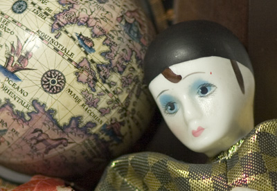

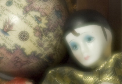

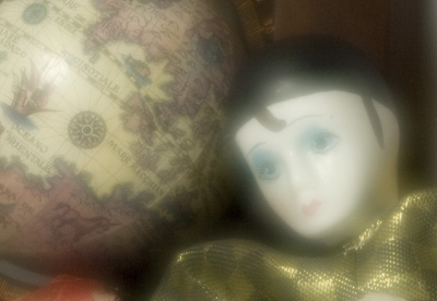

As mentioned above the lens
comes with a soft-focus option. Using a switch in conjunction with a
dedicated control ring you can set the soft-focus effect in three discrete
steps:
- "0" - no soft-focus (behaves like a normal tele photo lens)
- "1" - slight soft-focus effect
- "2" - strong soft-focus effect
The soft-focus generates some soft halos at contrast edges thus
generating a dreamy effect which feels a little dated to me but
your mileage may vary here.
