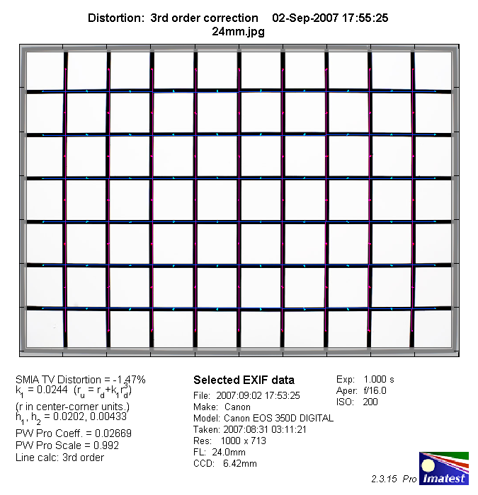

The level of distortions is comparatively low within the tested APS-C scope. At 24mm the lens shows only moderate barrel distortions (~1.5%) and at 40mm and 85mm the issue is pretty much negligible.
24mm 40mm 85mm

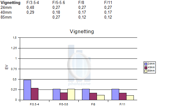

The Zeiss is a full format lens and it shows only a very low degree of vignetting (< 0.5EV) at wide-open aperture (APS-C DSLR). This is negligible under field conditions.

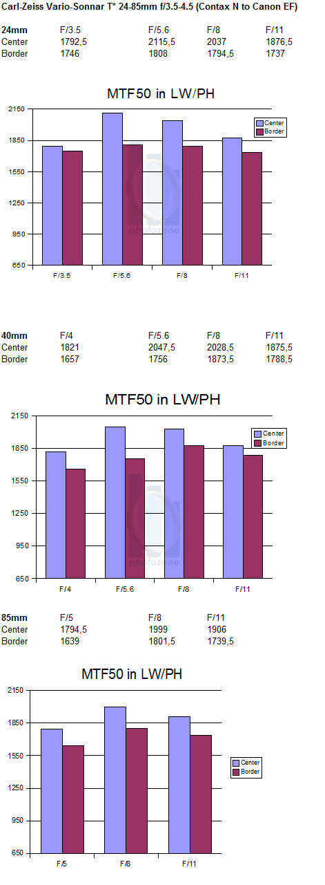

The Zeiss lens showed a very good and even resolution characteristic throughout its zoom range. The center resolution is generally very good at wide-open aperture and excellent beyond (till f/11) whereas the borders stay on a very good level. The peak performance is reached somewhere between f/5.6 and f/8.

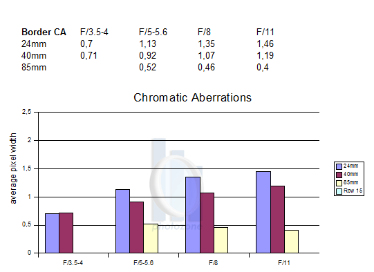

Chromatic aberrations (color shadows at harsh contrast transitions) are generally moderate for a standard zoom lens. As usual the lateral CAs are most pronounced at the wide end (0.7-1.5px at the borders). The problem decreases towards the long end of the zoom range and at 85mm the CAs are not field-relevant anymore.
