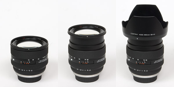

Typical for most Zeiss lenses the build quality is very good thanks to high quality materials. However, the lens uses a dual-cam design - two inner lens tubes extend when zooming towards the long end of the zoom range - and this sets limits to the build tolerances. Unfortunately the lens seems to suck in lots of air ... and dust. Used samples are never in perfectly mint condition in this respect. Thanks to an internal focusing (IF) mechanism the physical length remains constant during focusing (but not during zooming). The zoom ring operates a little stiff. Manual focusing feels smooth but it is a rather imperfect implementation because the mechanism doesn't interlock instantly. You may notice that the EOS 350D looks rather dwarfish in comparison - it is a relatively short but "fat" lens thanks to the big front elements and the huge 82mm filter thread.
As mentioned the Zeiss features an ultrasonic AF motor including FTM (full-time manual control in one-shot AF mode). It's not a speed daemon but reasonably fast and relatively accurate. Besides the mount conversion Conurus faced one little obstacle - Contax N lenses have no AF/MF switch (selected on the camera). However, he found a workaround for this: you have to set the (otherwise useless) aperture ring to the smallest aperture for manual focusing. This may be an unusual thought but it works just fine. Interestingly the new firmware (v2.+) has a new "AF micro-adjustment" feature - similar to the new EOS 1D III it is possibly to do a focus fine-tuning so if you're experiencing a front/backfocus problem you can easily correct this yourself (regardless of the camera model).
