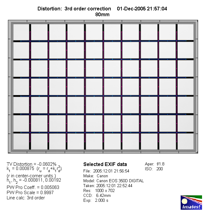

At its default position the Hartblei produces an absolutely negligible degree of distortions.

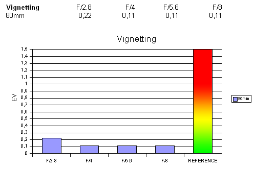

80mm:
The Hartblei 80mm MC is a full frame lens so it enjoys the usual sweet spot effect on an APS-C DSLR resulting in a negligible degree of vignetting.

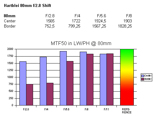

It is tricky to provide resolution figures for a tilt-shift lens because normally you don´t tend to use such a lens at default settings (with neither tilt nor shift). Anyway, here the center resolution is very fine throughout the tested aperture range with good figures at f/2.8 increasing to even excellent results at f/5.6. The edges are an entirely different story. At large aperture settings the results are dismal but there´s an extreme increase in quality at f/5.6 where the results are good (excellent at f/8). This indicates a rather extreme field curvature which may not be all that field-relevant because you don´t tend to shoot flat objects at large apertures. The field curvature may also be a side compromise of the tilt-shift design.

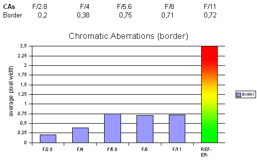

Chromatic Aberrations
Chromatic aberrations (color shadows at harsh contrast transitions) are quite low with the Hartblei which is typical for most fix-focal tele lenses.
