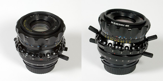

The optical design is made of just 6 elements in 5 groups without any special elements. The filter size is 62mm. As mentioned it is a tilt-shift lens with a tilt movement range of 0-8 degrees and a shift movement of 0-12mm. The rather fat lens has a weight of 800g. The minimum focus distance is 0.6m.
Unlike e.g. Canon TS-E lenses the Hartblei is more flexible because the tilt-shift function is not limited to a one axis. The tilt feature allows you to change the focus plane either to produce more or less depth-of-field than conventional lenses at the same aperture setting. The shift function can be used to correct a distorted perspective by producing a trapezoid image thus counteracting the distortion effect when using the lens off a strictly horizontal composition. Both features can be controlled via dedicated handles (sticks) which can be rotated (thus the name Super-Rotator) to the desired effect. Depending on the specific camera model the rear control stick can sometimes collide with the (camera build-in) flash housing (e.g. on the Canon EOS 10D) but you can remove the sticks and control the tilt/shift function directly via the underlying control rings (a little less convenient).
As mentioned above the lens doesn't provide AF (not unusual - it´s the same with Canon TS-E lenses) nor any aperture coupling - in fact the camera isn´t even aware that the lens is mounted. Therefore you have to the the camera to either manual or aperture-priority mode. It´s a little cumbersome at first but get used to it after a while. The build quality of the lens is pretty good which is typical for many russian made lenses. The focus ring operates very smooth and well damped and the aperture and tilt/shift ring offer discrete steps with pronounced "clicks".
