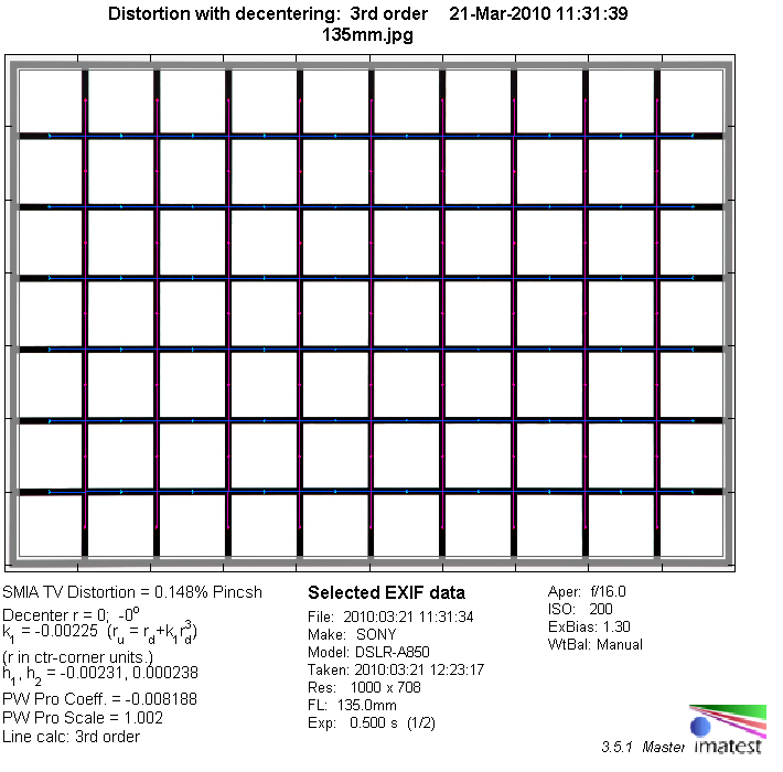

Typical for fix-focal length lenses in this range there're virtually no distortions to worry about (~0.15%).

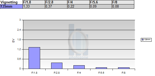

Full format sensors aren't exactly easy beings with respect to vignetting but the Zeiss is capable of delivering a good performance even at f/1.8. At around 1.3EV you will be able to notice some vignetting in the corners in certain scenes but within the full format scope this is actually pretty well controlled. The problem is basically negligible from f/2.8 onwards.

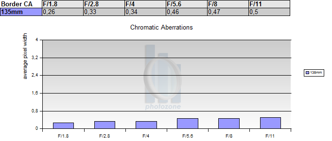

Lateral chromatic aberrations (color shadows at harsh contrast transitions) are exceptionally well controlled with an average CA-pixel width (border) between 0.26px @ f/1.8 and 0.5px @ f/8. Generally this is nothing to worry about in field conditions.

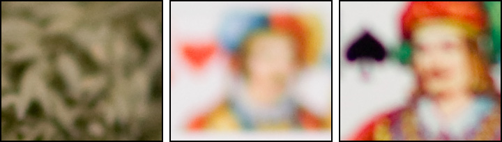

Longitudinal (Axial) Chromatic Aberrations (LoCA)
LoCAs (non-coinciding focal planes of the various colors), sometimes called "bokeh CAs", can be a visible in certain situations. This not unusual for such a lens but we hoped for a better performance here regarding the 2 large ED elements in the lens design but it's obviously not enough for a true apochromatic correction (=fully color corrected).
f/1.8 f/2.8 f/4
These figures have been recycled from the older APS-C review - the characteristic remains the same on full format cameras.
