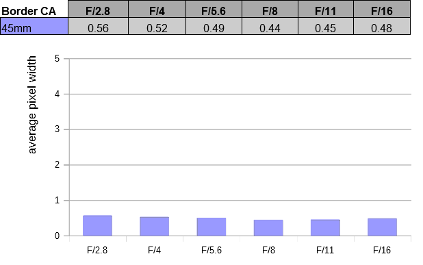

Once again - on Sony cameras, you don't really have to worry about chromatic aberrations due to image auto-correction. However, even if you prefer to disable this for whatever reason, the CAs are low at around 0.5px on the average at the image borders.
