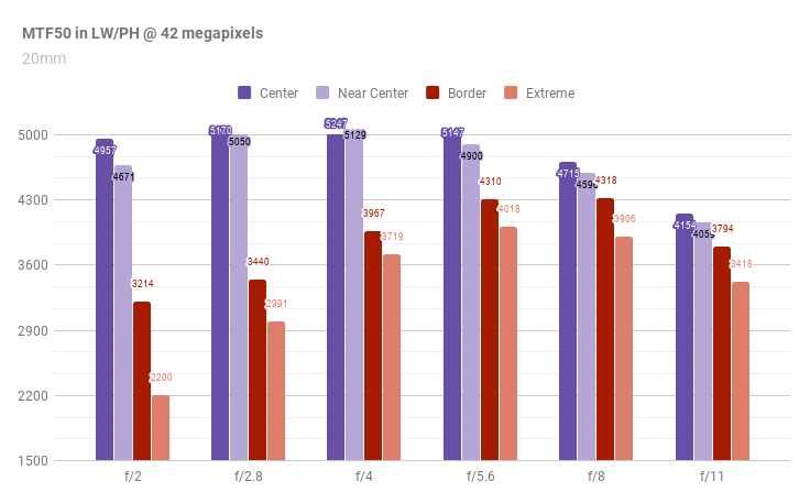

The Tokina FíRIN 20mm f/2 FE AF does a fine job in terms of resolution albeit it's not perfect - which is hardly surprising given the fast ultra-wide character. The most stunning aspect is the excessive sharpness in the wider center zone of the image field. The results are pretty much perfect here and between f/2 and f/5.6, the lens is surely capable of outperforming the 42-megapixel sensor of the test camera in this zone. The quality drops towards the borders/corners, of course, with f/2 as a weak spot. The borders are still Okay at this setting but the corners are soft. Stopping down to f/2.8 helps but better choose at least f/4 for good results. The sweet spot of the lens is reached between f/5.6 and f/8 with very good to excellent borders and very good corners. f/11 remains perfectly usable. Beyond diffraction has a more significant impact.
The field curvature is minimal. The centering quality of the tested sample was good.
