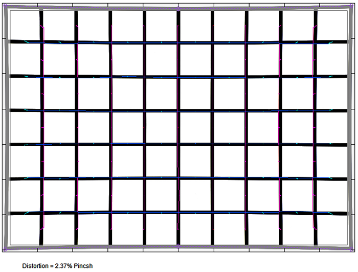

The Sony FE 100mm f/2.8 STF GM OSS produces a fairly pronounced degree of pincushion distortions (2.4%) in RAW mode. Given the fact that we are talking about a GM lens, this is a little disappointing. Of course, you can also enable image auto-correction which eliminates the issue.
Move the mouse cursor across the image to view the distortion chart in auto-corrected mode.

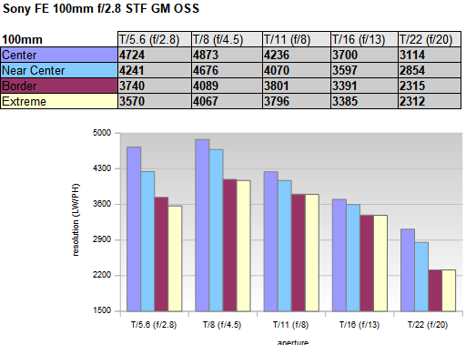

The Sony lens is capable of delivering very sharp results straight from T/5.6. The center quality is outstanding and the outer image field is still good to very good. The peak performance is reached at T/8 where the borders/corners are boosted to very good levels. Diffraction has an impact from T/11 onward. At T/16 the overall quality is still good to very good. However, T/22 (f/20) should be strictly avoided unless really needed.
The centering quality of the tested sample was very good. Field curvature is not an issue.

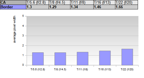

The Sony lens produces a fairly low amount of lateral CA (color shadows at harsh contrast transitions) starting with an average CA pixel width of 1.3px at T/5.6 increasing to 1.7px at T/22.

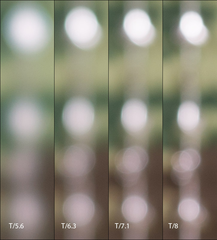

Out-of-focus highlights are usually rendered as distinctive discs. This is not the case at T/5.6. As you can see below the highlights smoothly dissolve towards their edges (suggesting a very dark outer area of the APD element). This is about as close to perfection as you can get. However, what you can also observe is that the effect is pretty much only visible in full at T/5.6. If you stop down by just 1/3 of an f-stop the effect is almost gone showing the conventional highlight discs again. These highlight discs are still quite nice although they show a bit of an increasing outlining effect the further you stop down. To be fair here - the Sony FE 100mm f/2.8 STF GM OSS is fairly slow thus you will pretty much always prefer to shoot at f/2.8 (T/5.6) anyway.

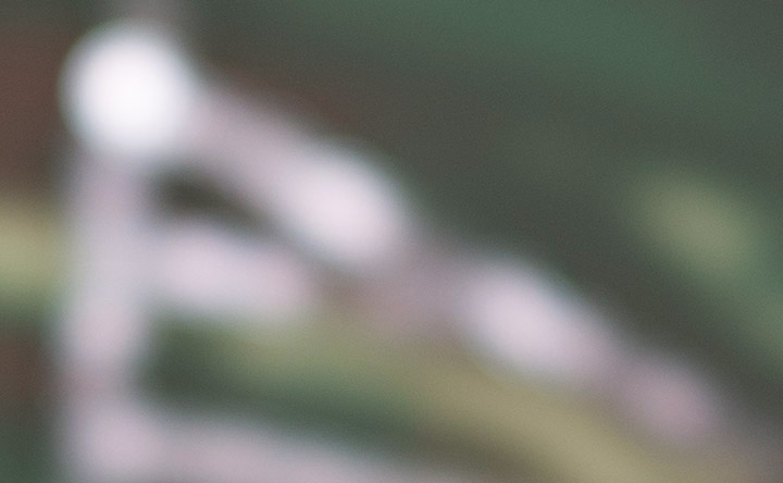

Another difference compare to conventional lenses is the quality of the highlights near the borders/corners. Usually you experience a deterioration of the highlight discs towards "cat eyes" whereas the STF lens is still capable of producing these nicely blurred discs here.

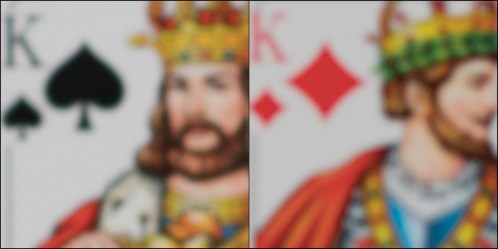

Unsurprisingly the general blur quality is also exceptionally smooth in the focus transition zones of both background and foreground. The blur is symmetrical and maintains a high color fidelity.
