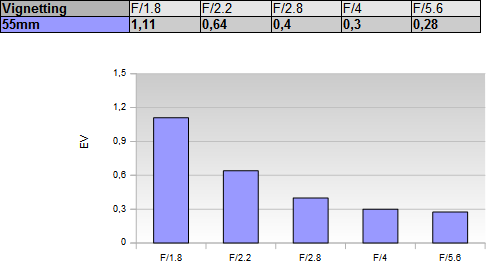

Full format lenses enjoy a sweet spot advantage when used on APS-C format cameras. The rather extreme vignetting that we've seen on the A7R II remains mostly outside of the APS-C image frame. That being said, there's still a noticeable amount (1.1EV) of vignetting left at f/1.8. Stopping down reduces the issue gradually and it's quite negligible from f/2.8 onward.
