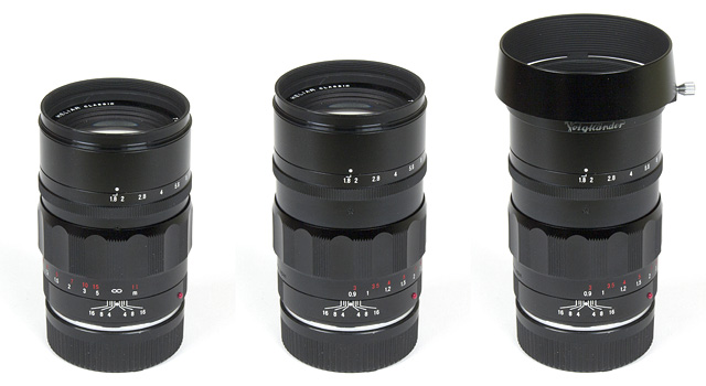

The build quality of the Voigtlander lens is superb thanks to a tightly assembled metal body. The focus ring operates smoothly (dampened) just like in the old times. The lens extends a little towards shorter focus distances but the front element does not rotate. A rather small metal lens hood is part of the package.
It is a comparatively long lens which is probably why it hasn't really perceived well by the size-addicted Leica M community. The Heliar has a very simple optical design but then it doesn't cost a fortune for that reason.
As mentioned it is a manual focus lens so you have to rely on Sony's focus peaking feature or magnified live view. This will slow you down, of course, but that's not necessarily a bad thing unless you want to do action photography.
