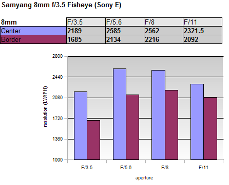

Anyway, the center resolution is already very good to excellent straight from f/3.5 whereas the borders are quite soft. However, the borders receive quite a boost at f/5.6 reaching very good figures here. Based on our field image we'd say that the extreme corners see a further improvement at f/8 though. f/11 is still perfectly usable but diffraction effects start to reduce the effect resolution here already.
The tested sample showed a centering issue on the far right image side.

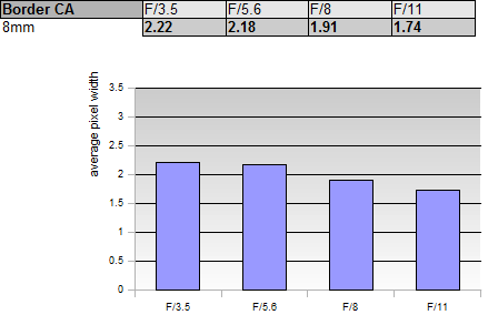

Fisheye lenses are extreme lenses by definition and their edge projection characteristic isn't exactly easy task for today's image sensors. Consequently there's quite an amount of lateral CAs (color shadows at the image borders) of around 2px (width) at the image borders and some more in the extreme corners. This may sound worrisome but this is in line with other fisheye lenses that we've tested so far.
However, even such an amount of lateral CAs can be corrected during post-processing (e.g. in Photoshop).
