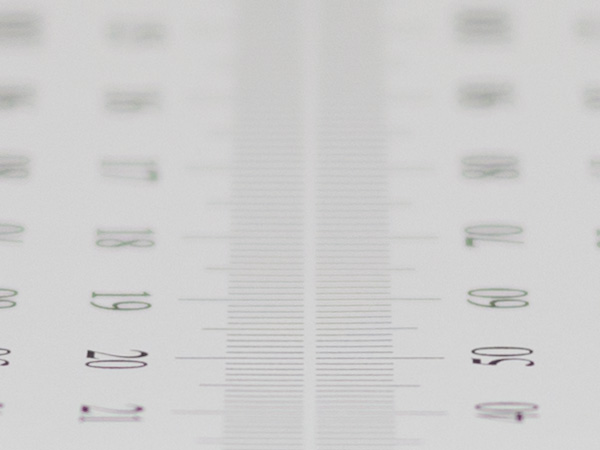

LoCAs (non-coinciding focal planes of the various colors) are a common issue with relatively fast glass. As you can notice below the halos have different colors - magenta (red + blue) in front the focus point and green beyond. This is primarily a problem at f/2.5 The issue dissolves from f/4 onwards.
Upon closer observation you may also be able to spot a fairly obvious focus shift towards the background when stopping down - this is rather typical for fast lenses.
