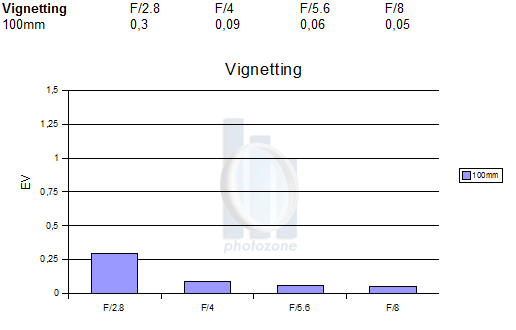

The Sony 100mm f/2.8 is a full format lens and as such enjoying the usual sweet spot advantage when used on an APS-C DSLR. Within this scope the lens shows already marginal vignetting at f/2.8 (0.3EV) and the problem is absolutely negligible from f/4 onwards.
