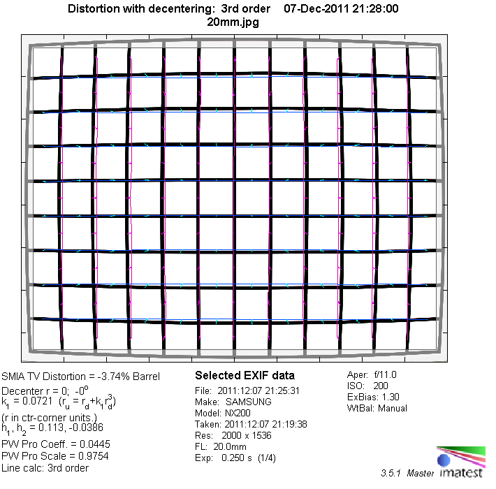

The lens produces a heavy barrel distortion of 3.7% at 20mm. In JPEG mode you will usually not have to worry because the camera is set to auto-correction per default. In the middle to upper range there's nothing to worry about in this respect.
Interestingly you cannot disable the auto-correction in the camera (at least on the NX200) but the RAW images carry the untouched information anyway.
