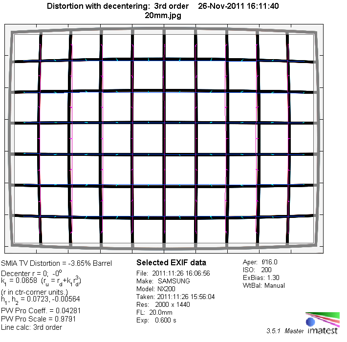

Lens distortions are usually auto-corrected either in the camera directly or in Capture One (Samsung's RAW converter). However, it is possible to disable this feature.
The native distortion characteristic of the NX 20mm f/2.8 is below average - a barrel distortion of ~3.6% will be visible in many scenes.

As a little update we've provided the quality ratings for the scenario with and without distortion correction.
Distortion auto-correction DISABLED:

The distortion correction may fix this issue but, as a side effect, the image gets "stretched" and up-scaled to the original size. However, due to the image cropping it does also reduce some corner issues. The center performance is only marginally impacted by this but the corner stretching doesn't come for free - you are roughly loosing about a 3/4 quality mark here across the aperture range.

Pancake lenses cannot be perfect - the small size simply implies some compromises. However, the Samsung NX 20mm f/2.8 does a pretty good job actually. At f/2.8 you have to live with some corner softness and quite high vignetting. However, the center resolution and contrast is already very decent here. The results are very sharp when stopping down to medium aperture settings. Diffraction is a limiting factor from f/11 onward. Lateral CAs are usually nothing to worry about. A primary weakness of the lens is the heavy amount of barrel distortion. That said, most users will probably prefer to enable distortion auto-correction anyway.
