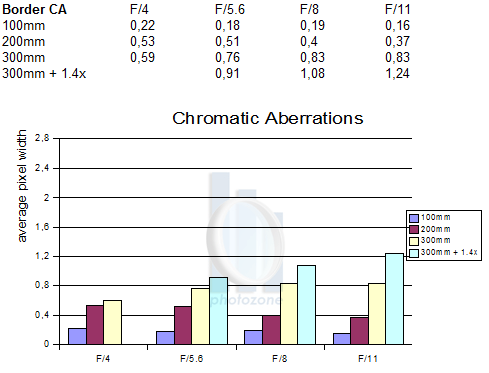

Lateral CAs (color shadows at harsh contrast transitions) are very well controlled in the native 100-300mm range. The average CA pixel width at the borders varies between extremely low ~0.2px (100mm) and ~0.8px (@ 300mm). The situation deteriorates when adding the AF 1.4x EX DG converter resulting in more noticeable CA pixel widths of around 1.1px.
