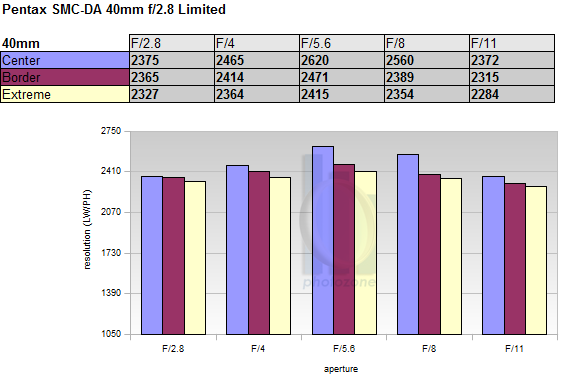

The Pentax lens delivered an impressive performance in the MTF lab. The lens is already capable of delivering very good results at f/2.8 across the frame. The excellent peak is reached at f/5.6. Typical for all lenses diffraction reduces the quality from f/11 onwards.
