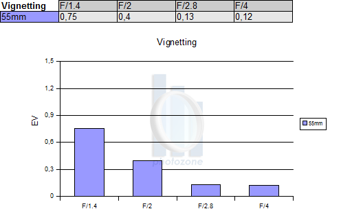

The amount of vignetting is very well controlled. At f/1.4 it is naturally most pronounced at ~0.75EV - this may be visible in very critical situations but it is no worse than comparable lenses here. It is also an indication that the lens covers more than just the APS-C image circle. From f/2 onwards the vignetting is no longer field-relevant.
