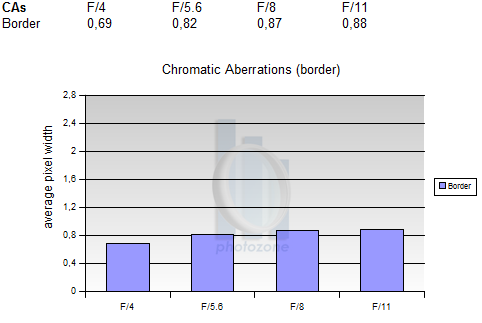

Lateral chromatic aberrations (color shadows at harsh contrast transitions) are fairly well controlled for a lens in this focal length class. The average CA pixel width at the image borders stays at and below 0.9px - this may be visible here and there but usually not to an annoying degree.
(Note: CAs can be reduced via imaging tools)
