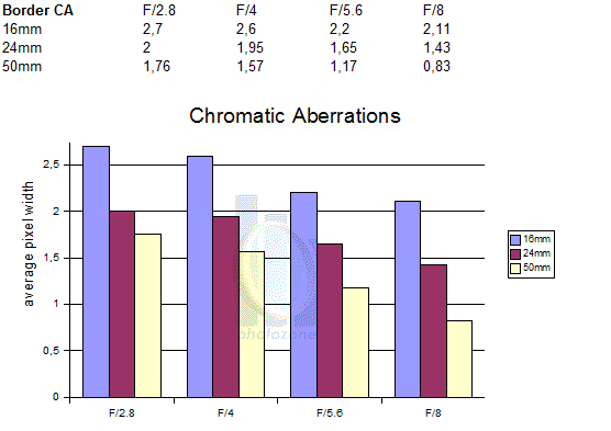

CAs (color shadows at harsh contrast transitions) are the primary weakness of the Pentax lens. At 16mm @ f/2.8 the CAs peak beyond 2.5px on the average at the image borders. Stopping down improves the problem quite a bit without resolving it. At longer focal lengths the CAs could still be better at f/2.8 but beyond f/4 it is generally well controlled.
