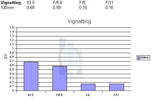

The Cosina is a full format lens but it does still produce a moderate amount of vignetting at f/3.5 and f/5.6. The problem is negligible from f/8 onwards. The marginal decrease from f/3.5 to f/5.6 is a bit surprising. Regarding the exposure characteristic of the lens it seems likely that we're probably more talking about f/4.5 rather than the f/5.6 on paper.

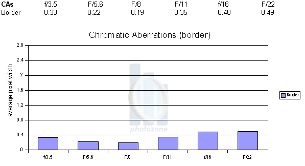

Lateral chromatic aberrations (color shadows at harsh contrast transitions) are very low and not really field relevant at all tested settings.
