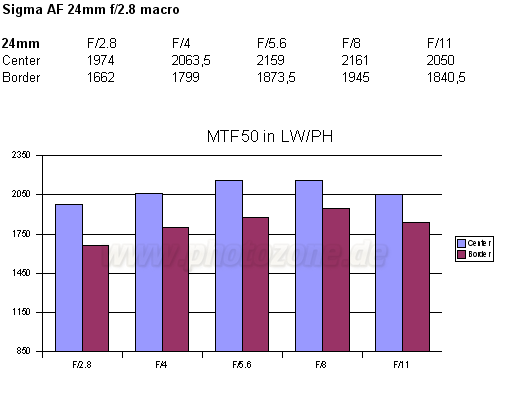

The Sigma AF 24mm f/2.8 macro produced very good to excellent resolution figures in the MTF lab. At wide-open aperture the center performance is already very high followed by good quality at the borders. Stopping down results in a gradual improvement till the peak resolution is reach at f/8 with an excellent center and very good borders. Typical for most lenses diffraction effects start to reduce the quality from f/11 onwards.
