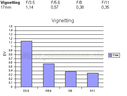

As mentioned the Tokina is a full format lens so it has a sweet-spot advantage when used on an APS-C DSLR. However, at f/3.5 the amount of vignetting is still fairly heavy (~1.14EV). Stopping down to f/5.6 and beyond reduces the problem to a manageable degree.
