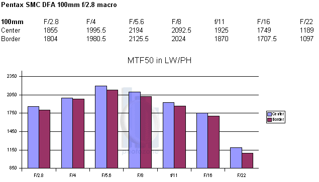

The DFA 100mm f/2.8 macro produced very high resolution figures in the MTF lab but it isn't necessarily a step forward compared to its predecessor. At f/2.8 the resolution is very good (just) and very even. Stopping down provides a extra kick till reaching excellent quality levels at f/5.6. From f/8 the resolution figures are heading southbound again due to diffraction effects - this is a physical limitation. The lens is capable to maintain a high quality level till about f/16. f/22 should be generally avoided, more so f/32 which is also possible.
Interestingly the contrast level of the DFA 100mm f/2.8 macro seems obviously higher compared to the old FA 100mm f/2.8 macro.

Below is a simplified summary of the formal findings. The chart shows in line widths per picture height (LW/PH) which can be taken as a measure for sharpness. The chart is limited to the visually relevant LW/PH range of [850, 2350]. If you want to know more about the MTF50 figures you may check out the corresponding Imatest Explanations. Please note that the results are only comparable within the Pentax lens test group!.
