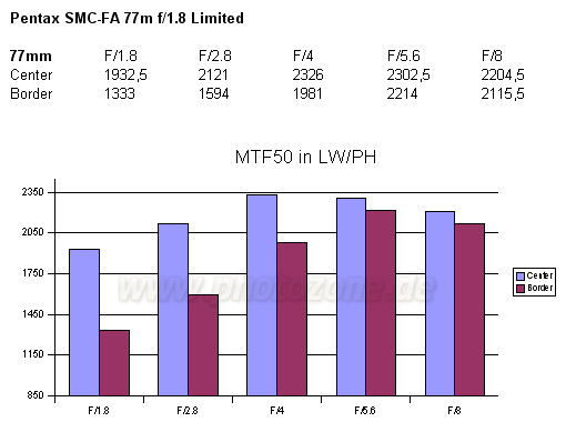

The FA 77mm f/1.8 Limited produced very good to excellent resolution figures in the MTF lab. At f/1.8 the center performance is already very fine but the borders quality isn't there yet. This may sound unimpressive but for portraits, surely the typical application for the lens, this characteristic isn't really much of an issue because the subject tends to be close to the center here anyway. Stopping-down to f/2.8 lifts the center resolution to excellent levels whereas the borders improve to good figures. The performance peak is reached at f/5.6 with an outstanding center and excellent borders.
Below is a simplified summary of the formal findings. The chart shows in line widths per picture height (LW/PH) which can be taken as a measure for sharpness. The chart is limited to the visually relevant LW/PH range of [850, 2350]. If you want to know more about the MTF50 figures you may check out the corresponding Imatest Explanations. Please note that the results are only comparable within the Pentax lens test group!.
