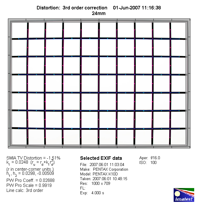

The FA* 24mm f/2 exhibits a fairly low degree of barrel distortions (1.5%) which is better than average for a lens in this class.

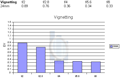

As a full format lens the FA* 24mm f/2 benefits from the usual sweet spot effect on APS-C DSLRs. However, it is also an ultra-large aperture lens so it does still produce quite high degree of vignetting at f/2 (0.89EV) even within this scope. The problem is negligible from about f/4 onwards.

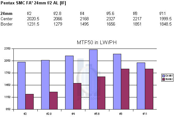

The Pentax lens has a very sharp center performance straight from f/2. However, the border quality is fairly dismal here. This doesn't really change till about f/4 where the border resolution finally reaches good levels. The center resolution peaks at f/5.6 with absolutely superb figures whereas the borders require f/8 to reach very good quality.
It is worth to mention that the lens seems to produce a very high degree of contrast even at f/2. "Sharpness" is a combination of resolution and contrast so subjectively the image results may appear better than suggested by the graphs - probably one of the reasons for the varying user impressions out there.

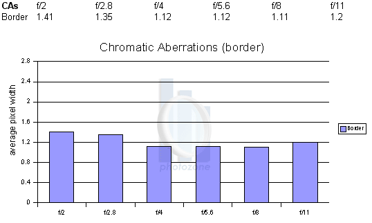

Lateral chromatic aberrations (color shadows at harsh contrast transitions) are not a a real strong point of the FA* 24mm f/2. The problem reaches an average pixel width of around 1.2px at the image borders. This is not a worryingly high degree but noticeable at times.
