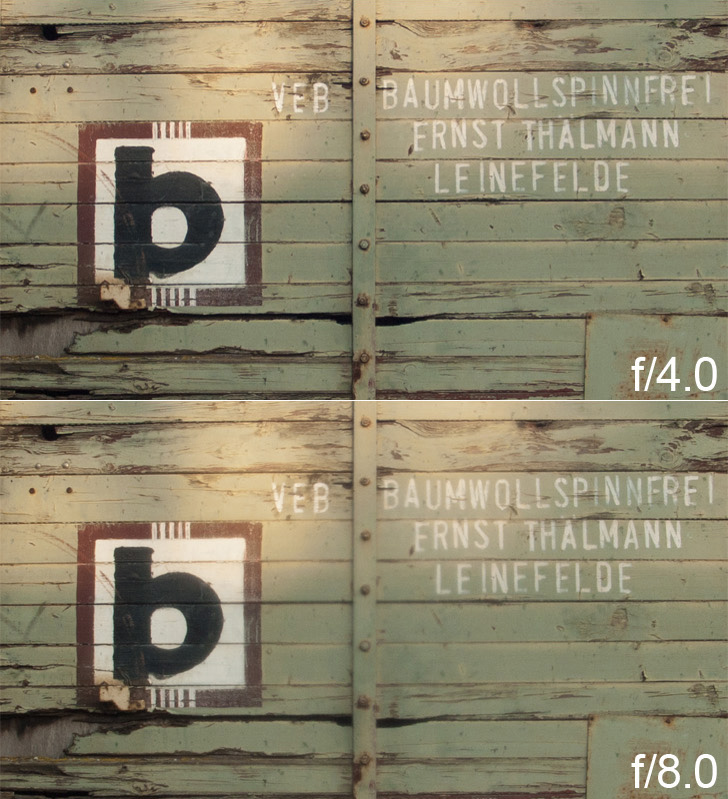

Strange Issue
The following figures shows a crop of the image center at apertures from f/4 and f/8. Starting at f/5.6 the sharpness drops at a certain small spot clearly noticeable below 1200 LW/PH. It's hard to imagine the origin of this issue but according to SLR Magic caused by lens flare.
