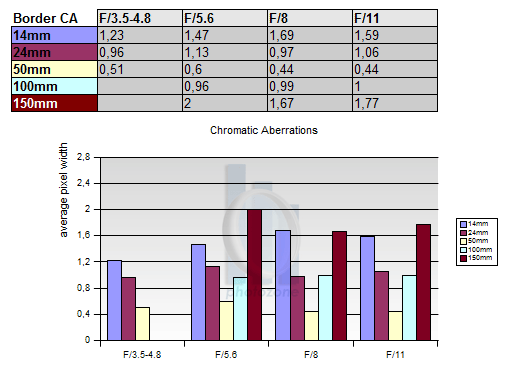

Everything looked pretty rosy so far but the Leica lens has one weakness - lateral CAs. These color shadows are very pronounced at 14mm and at 150mm with an average CA width of around ~1.5px at the image borders. The maximum of 2px is reached at 150mm @ f/5.6. This can be disturbing. From 24mm to 100mm this is a lesser issue.
Please note that lateral CAs are correctable during post-processing but it's an additional manual step.
