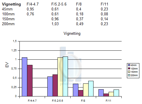

The 45-200mm G shows a fairly strong degree of vignetting at wide open aperture - at around ~1EV the issue will be visible in some scenes. The problem dissolves when stopping down by 1 f-stop. Interestingly the aspect is not auto-corrected in Adobe Camera RAW so it depends on the specific lens.

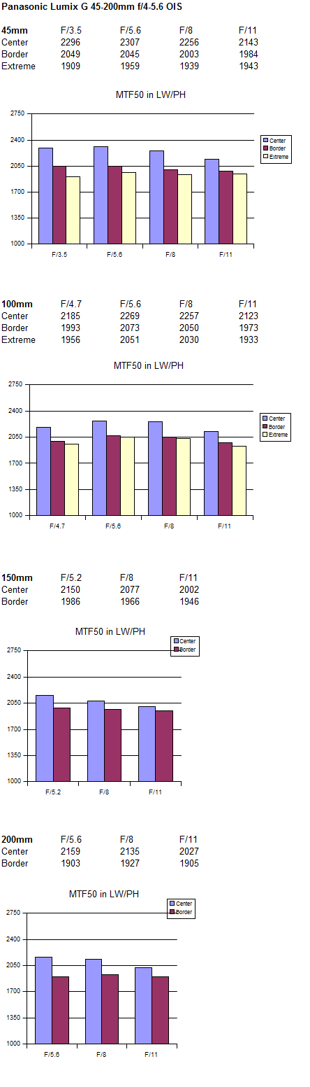

The lens produced very good center resolution figures throughout the range. The border quality is generally good. There's a slight drop in performance at the long range - this is quite typical for such lenses. FWIW, the 200mm setting does benefit quite a bit from the auto-correction.
Below is a simplified summary of the formal findings. The chart shows in line widths per picture height (LW/PH) which can be taken as a quantity for sharpness. If you want to know more about the MTF50 figures you may check out the corresponding Imatest Explanations.

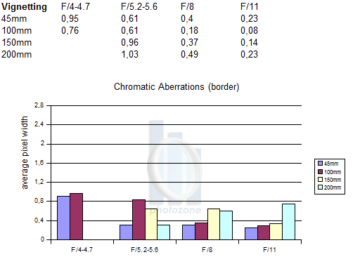

Lateral chromatic aberrations (color shadows at harsh contrast transitions) are heavily auto-corrected specifically at the long end. The non-corrected RAWs have CA peaks way beyond 2px at the image borders at 200mm. As you may notice belong the problem is very much reduced after the auto-correction. Interestingly most of the correction is done on the red-cyan CA variant whereas some blue fringing remains.
