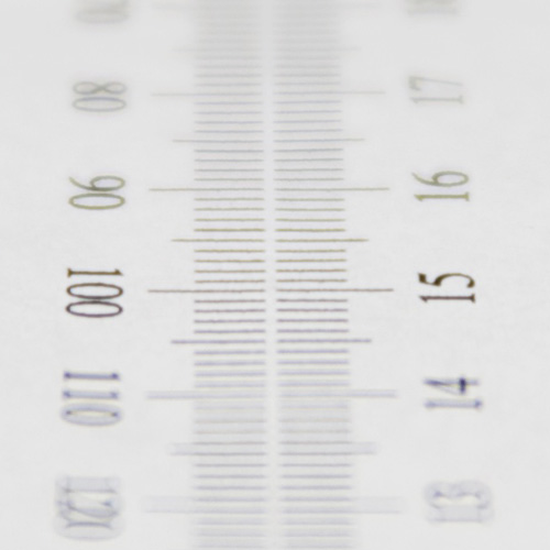

Bokeh fringing (non-coinciding focal planes of the various colors) is an issue often found on fast lenses. It's visible as halos of different colors in out-of-focus areas - usually magenta (red + blue) in front the focus point and green beyond. Surprisingly the Tamron is only marginally affected.
If you scroll through the images below you may notice a slight shift in focus when stopping down. This is a so-called "residual spherical aberration".
