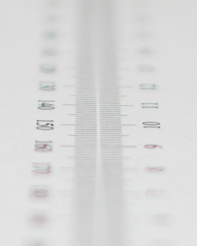

LoCAs (non-coinciding focal planes of the various colors) are a common issue with relatively fast glass. As you can notice below the halos have different colors - magenta (red + blue) in front the focus point and green beyond. Truly "apochromatic" lenses don't show LoCAs but these lenses are very rare especially below 100mm. Unlike lateral lateral CAs, LoCAs cannot easily be fixed in post processing.
Typical for most fast primes, especially ultra fast ones, the AF-S 24 shows some amount of LoCAs at large aperture settings, which can of course be reduced by stopping down.
In addition, these shots also show the focus shift when stopping down.
