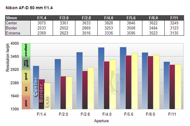

Standard primes have a reputation of delivering sharp images and the AF-D 50 does not disappoint in this regard.
In the image center the resolution is very good wide open already, reaching excellent figures at f/2.8. The borders and extreme corners start a little softer wide open (where the lens also lacks some contrast), but also improve by stopping down, reaching very good levels at f/4 and excellent sharpness at f/5.6 and f/8.
From f/2.8 onwards the extreme corners deliver slightly higher resolution figures than the borders.
The lens showed some focus shift when stopping down (residual spherical aberration).
Below is a simplified summary of the formal findings. The chart shows in line widths per picture height (LW/PH) which can be taken as a measure for sharpness. The chart is limited to the visually relevant LW/PH range of [1300, 4000]. If you want to know more about the MTF50 figures you may check out the corresponding Imatest Explanations.
