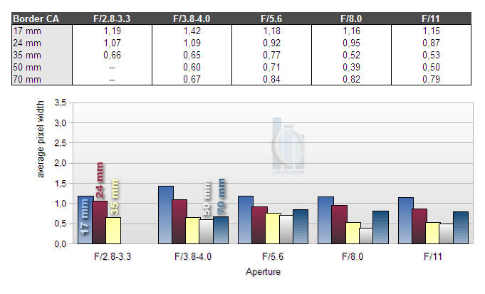

Lateral CAs (color shadows at harsh contrast transitions) are very well controlled including the critical 17mm setting. The CAs reach values of just below 1.5 pixels here. This may be noticeable at 100% image magnification on your screen but it's not really relevant anymore for prints.
In addition, please note that CAs can easily be corrected in software or by the camera itself (most modern Nikon DSLRs remove CAs themselves if you shoot JPGs).
