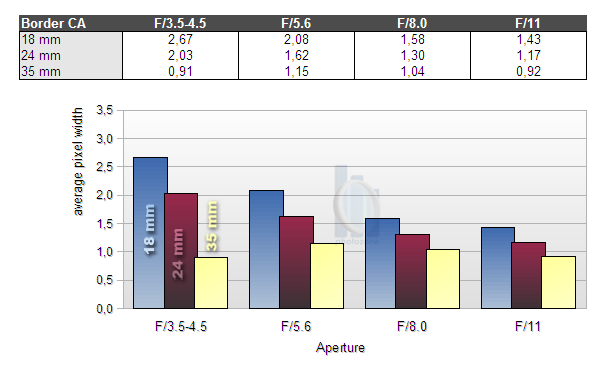

Lateral CAs (color shadows at harsh contrast transitions) are well controlled for such a lens. The largest amount is visible at the shortest focal length and the largest aperture. Zooming in and stopping down reduces the amount of CAs to lower levels.
Note that CAs can easily be corrected in software or by the camera itself (most modern Nikon DSLRs remove CAs themselves if you shoot JPGs).
