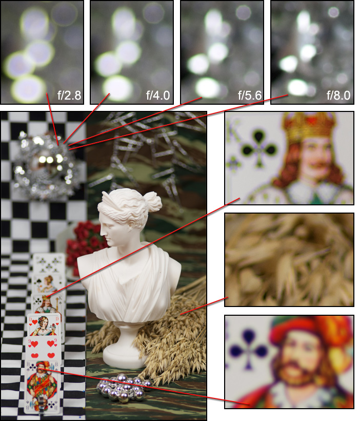

One of the primary usage scenarios for a large aperture lens is to seperate the main subject from the background. In such an image the quality of the bokeh (out-of-focus blur) is of major significance.
The background blur shows some signs of nervousness in the transition zone from in-focus to out-of-focus, but apart from that is generally quite smooth.
Background highlights show only a very small amount of outlining and are actually well rendered. However, they are slightly condensed towards the image borders due to mechanical vignetting and start to lose their circular shape at apertures of f/5.6 and smaller. In addition, there's a visible amount of bokeh fringing (green outlines, see next section).
Typical for most fast primes the AF-D 180 shows noticeable bokeh fringing at large aperture settings, which can of course be reduced by stopping down.
f/2.8 f/4.0 f/5.6 f/8.0 f/11
