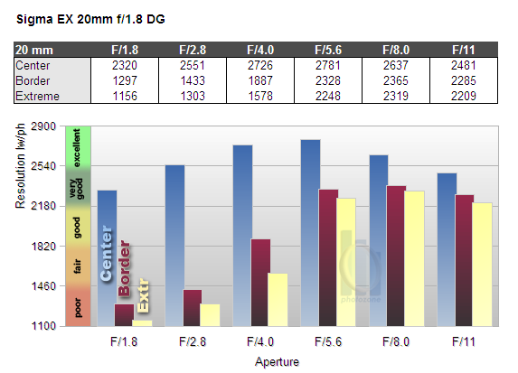

The lens shows very good resolution in the image center wide open, which increases to excellent levels by stopping down.
The borders and corners are a very different story, though. Both are poor wide open and and when stopped down to f/2.8. However, from f/5.6 onwards both areas show significantly increased values and the lens is able to deliver very good resolution across the whole DX frame.

Just like its slightly longer sister lenses, the Sigma AF 20mm f/1.8 EX DG leaves us with mixed feelings. The center resolution of the lens is very good to excellent, while the borders and corners disappoint at large apertures. Stopped down, the resolution is very good across the DX frame, though.
