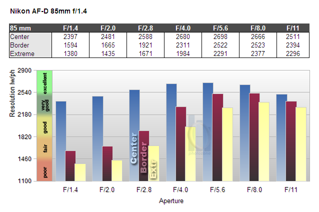

The AF-D 85/1.4 produced mixed results in our lab tests. The center resolution is very good wide open already, increasing to excellent figures by f/2.8.
The borders and corners however show a different behaviour, starting of very soft wide open. The lens needs to be stopped down quite a bit to reach very good sharpenss in these areas.
The lens showed some focus shift when stopping down (residual spherical aberration).

The Nikkor AF 85mm f/1.4 D delivers very good to excellent sharpness in the image center, is basically free of distortion and produces very creamy and pleasing bokeh. Vignetting is moderate wide open, but actually well under control for such a large aperture lens. Lateral CAs are well controlled and usually not field relevant.
It's not without flaws, though. Typical for this lens class, it shows a significant amount of bokeh fringing. A little disappointing is its lack of sharpness towards the image borders and corners. So, technically, in summary the lens is not all that great.
