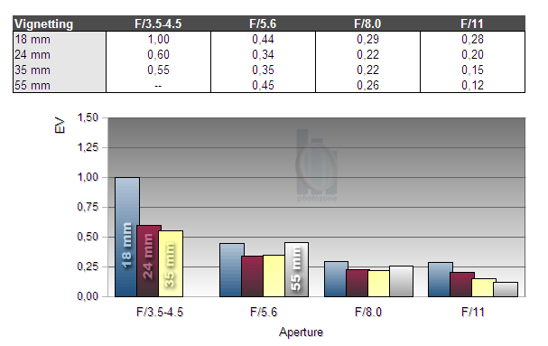

Vignetting is well under control, especially compared to the lens' successor. Wide open at the shortest focal length, the lens shows light falloff towards the corners that can be visible and maybe disturbing, but stopping down just 1 stop reduces vignetting to a level that is hardly field-relevant anymore.
