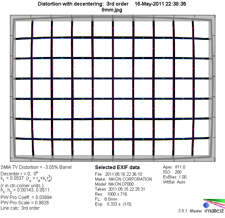

The AF 8-16mm f/4.5-5.6 produces a fairly heavy amount of complex barrel distortion (~3%) at 8mm. However, this is typical for ultra-wides and the Sigma is wider than usual to start with. The good news is that it shows basically no significant distortions from 12mm onwards although there's still a bit of a wavy sub-frequency left here.
8mm 12mm 16mm
