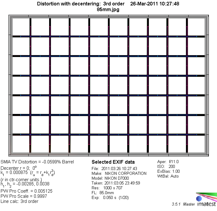

The Sigma produces an absolutely negligible degree of barrel distortion on DX cameras.
