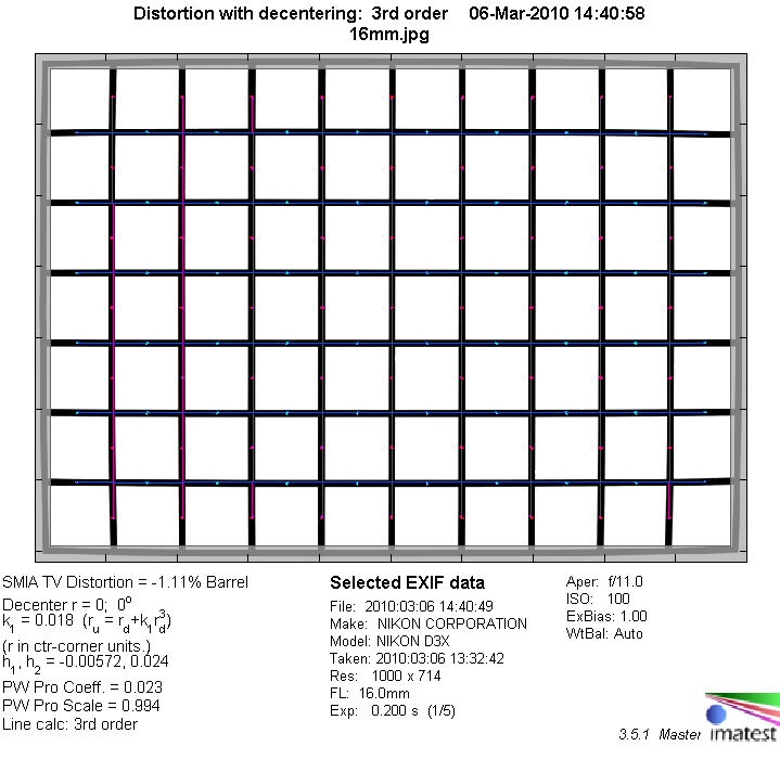

In our FX review, the 16-35 VR showed a less than stellar distortion characteristic. It's typical for FX lenses to perform significantly better on smaller DX sensors in this regard, however the amount of improvement is surprising nonetheless.
At 16mm the lens shows barrel distortion of just above 1.1%. This can be visible in the field with certain subjects, but it's less than many other lenses in this focal range. At longer focal lengths, distortion switches over to the pincushion type, however it's low enough to not be really field-relevant.
16mm 24mm 35mm

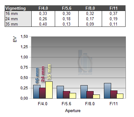

Vignetting is usually not a significant problem of FX lenses on DX cameras. This is especially true for lenses with rather moderate maximum aperture settings. So, with light fall off values of clearly below 0.5 EV, vignetting is no issue at all with this lens.

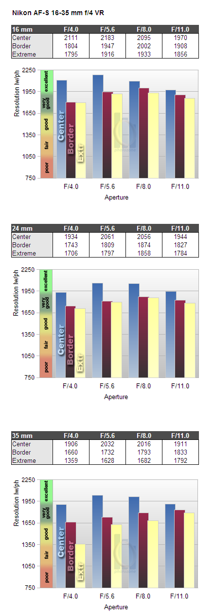

The lens shows very good to excellent center sharpness at all focal lengths, the borders and corners follow closely behind with very good sharpness at lower focal lengths. Only at 35mm the corners sharpness drops significantly wide open and the lens needs to be stopped down to f/8 to show very good sharpness across the frame at this focal length.

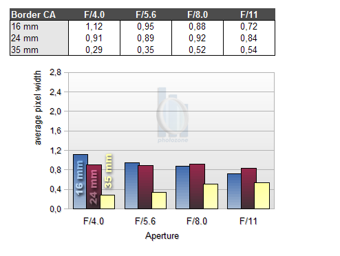

Chromatic aberrations (color shadows at harsh contrast transitions) are in the range of roughly 1 pixel at the image borders throughout most of the focal and aperture range. Only at 35mm the amount of CAs is a bit lower, reaching just above a half pixel stopped down to f/11 and even less with larger aperture.
CAs can easily be corrected in software or by the camera itself (most modern Nikon DSLRs remove CAs themselves if you shoot JPGs).
